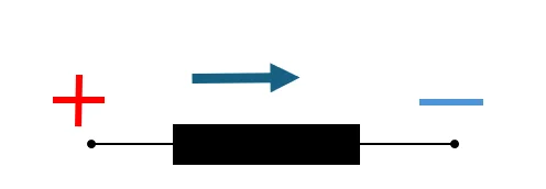

مشاهدة المرفق 12063
P.S.C is satisfied*
voltage drope*
p=+iv*
absorb positive power*
subbly/generate negative power*

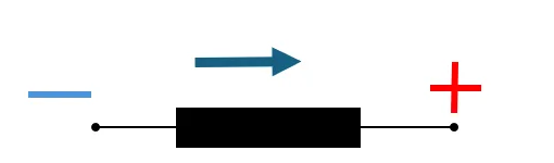

مشاهدة المرفق 12064
P.S.C is not satisfied*
voltage rise*
p=-iv*
absorb negative power*
subbly/generate positive power*
